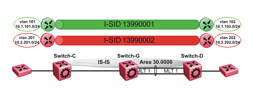

The following figure shows a sample Layer 3 VSN deployment.
The following sections show the steps required to configure the Layer 3 VSN parameters in this example.
Note that IP IS-IS redistribution needs to be configured to inject the VRF routes into IS-IS.
You must first configure basic SPBM and IS-IS infrastructure.

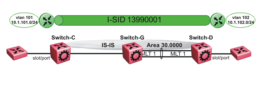

VRF green configuration
The following figure shows the green VRF in this Layer 3 VSN example.
The following sections show the steps required to configure the green VRF parameters in this example.
VRF green – Switch-C
VRF CONFIGURATION ip vrf green vrfid 1 VLAN CONFIGURATION vlan create 101 type port-mstprstp 0 vlan mlt 101 1 vlan members 101 1/2 portmember interface Vlan 101 vrf green ip address 10.1.101.1 255.255.255.0 1 exit ISIS PLSB IPVPN CONFIGURATION router vrf green ipvpn i-sid 13990001 ipvpn enable exit IP REDISTRIBUTION CONFIGURATION - VRF router vrf green isis redistribute direct isis redistribute direct metric 1 isis redistribute direct enable exit IP REDISTRIBUTE APPLY CONFIGURATIONS isis apply redistribute direct vrf green
VRF green – Switch-D
VRF CONFIGURATION ip vrf green vrfid 1 VLAN CONFIGURATION vlan create 102 type port-mstprstp 0 vlan mlt 102 1 vlan members add 102 1/2 portmember interface vlan 102 vrf green ip address 10.1.102.1 255.255.255.0 1 exit ISIS PLSB IPVPN CONFIGURATION router vrf green ipvpn i-sid 13990001 ipvpn enable exit IP REDISTRIBUTION CONFIGURATION - VRF router vrf green isis redistribute direct isis redistribute direct metric 1 isis redistribute direct enable exit IP REDISTRIBUTE APPLY CONFIGURATIONS isis apply redistribute direct vrf green

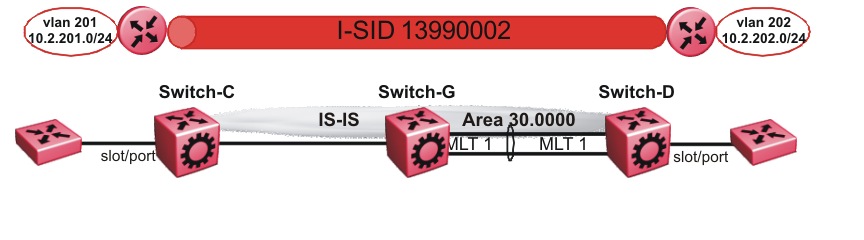

VRF red configuration
The following figure shows the red VRF in this Layer 3 VSN example.
The following sections show the steps required to configure the red VRF parameters in this example.
VRF red – Switch-C
VRF CONFIGURATION ip vrf red vrfid 2 VLAN CONFIGURATION vlan create 201 type port-mstprstp 0 vlan mlt 201 1 vlan members 201 1/2 portmember interface Vlan 201 vrf red ip address 10.2.201.1 255.255.255.0 1 exit ISIS PLSB IPVPN CONFIGURATION router vrf red ipvpn i-sid 13990002 ipvpn enable exit IP REDISTRIBUTION CONFIGURATION - VRF router vrf red isis redistribute direct isis redistribute direct metric 1 isis redistribute direct enable exit IP REDISTRIBUTE APPLY CONFIGURATIONS isis apply redistribute direct vrf red
VRF red – Switch-D
VRF CONFIGURATION ip vrf red vrfid 2 VLAN CONFIGURATION vlan create 202 type port-mstprstp 0 vlan mlt 101 1 vlan members 202 1/2 portmember interface Vlan 202 vrf red ip address 10.3.202.1 255.255.255.0 1 exit ISIS PLSB IPVPN CONFIGURATION router vrf red ipvpn i-sid 13990002 ipvpn enable exit IP REDISTRIBUTION CONFIGURATION - VRF router vrf red isis redistribute direct isis redistribute direct metric 1 isis redistribute direct enable exit IP REDISTRIBUTE APPLY CONFIGURATIONS isis apply redistribute direct vrf red
